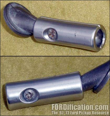

Does your mirror bracket have the phillips screws to tighten the two ball pivots or are they the crimped style?

As Barry mentioned, if your mirror mount has these screws, you can just tighten them up a bit to fix your problem. Otherwise you'll have to crimp them a bit tighter:
