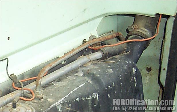

Putting the tank in that someone else took out. wanted to get the lines run correctly. Can someone snap a picture of theirs, or at least take a look and tell me if the line runs in front of, or behind the filler neck?

This picture is from a tank also equipped with the emission-control venting, in case yours has that as well. If not, the line still routes the same.

Oh, well I got it worng on the top for sure!
Could I be a pest, and ask if you could show me a picture of the bottom 1/2 of the tank and where the line goes thru the floor?

Here's a couple more of the top and two of floor.
